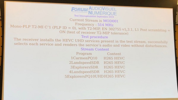

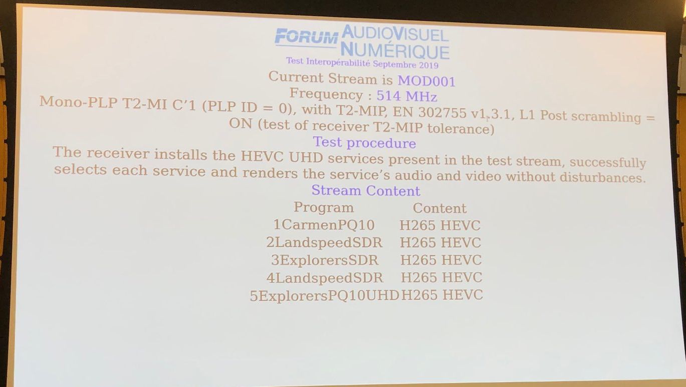

Messagepar Franck Morin » 20 Oct 2019 05:21
Messages: 19540
