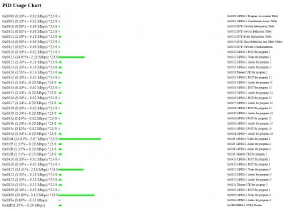

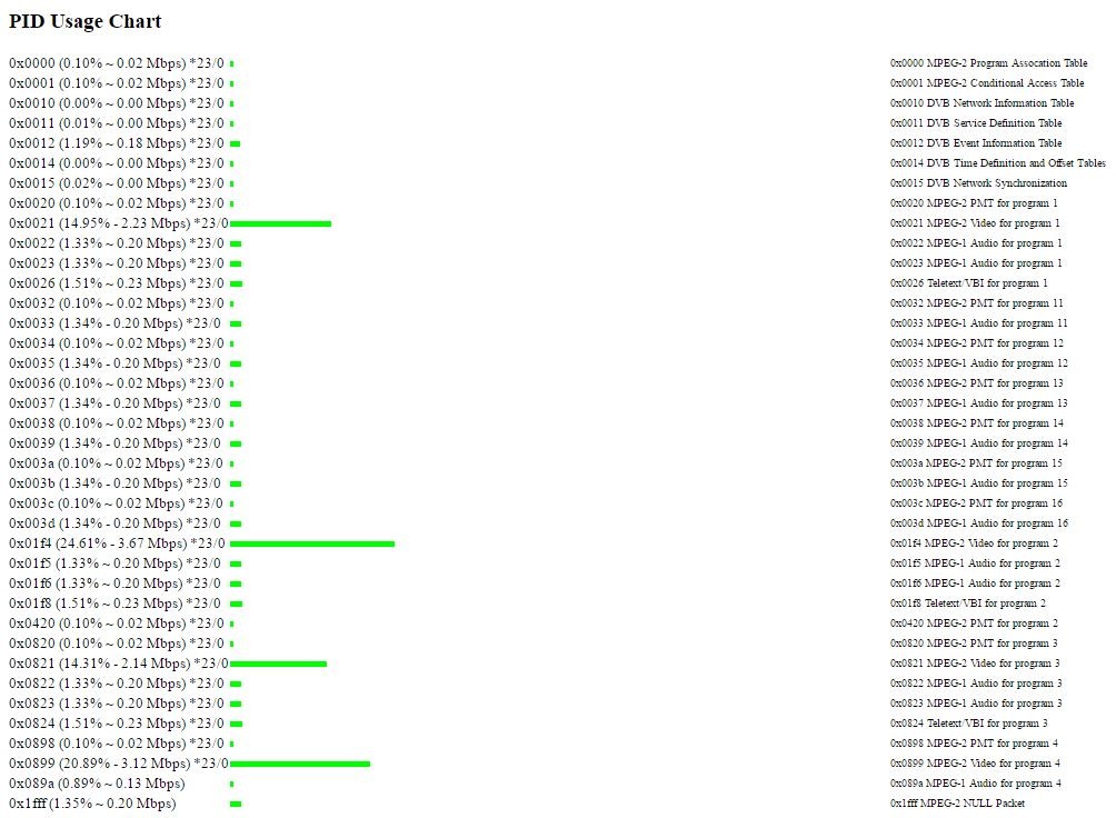

Les données brutes fournies par TSReader pour avoir les caractéristiques détaillées :
Canal 56
Program Association Table
PAT Version Number: 21
Transport Stream ID: 10 (0x000a)
NIT: 754.0 MHz
PMT PID 32 (0x0020) - Program 1 la une EIT Link
PMT PID 1056 (0x0420) - Program 2 la deux EIT Link
PMT PID 2080 (0x0820) - Program 3 la trois EIT Link
PMT PID 2200 (0x0898) - Program 4 EURONEWS
PMT PID 50 (0x0032) - Program 11 La Prem1ere
PMT PID 52 (0x0034) - Program 12 musiq3
PMT PID 54 (0x0036) - Program 13 Classic 21
PMT PID 56 (0x0038) - Program 14 VivaCite
PMT PID 58 (0x003a) - Program 15 brf
PMT PID 60 (0x003c) - Program 16 Pure FM
Program Map Table(s)
Program Number: 1 la une
Stream Type: 0x02 MPEG-2 Video PID 33 (0x0021)
MPEG Video: Bitrate 15.000 Mbps Resolution 720 x 576i
MPEG Video: Framerate 25 fps Aspect Ratio 16:9 Chroma Format 4:2:0
AFD descriptor: 16:9 (center)
Stream Type: 0x03 MPEG-1 Audio PID 34 (0x0022)
MPEG1 Audio: Bitrate 192 Kbps Sample Rate 48 KHz
MPEG1 Audio: Layer II Mode Stereo
Descriptor: ISO639 Language Descriptor
Language: fra
Audio type: undefined
Stream Type: 0x03 MPEG-1 Audio PID 35 (0x0023)
Language: V.O
Stream Type: 0x06 Teletext/VBI PID 38 (0x0026)
Descriptor: VBI Data Descriptor
EBU teletext Line Offset: 21 Field parity: 0
WSS Line Offset: 23 Field parity: 1
Descriptor: Teletext Descriptor
Language: fra Type: Initial Teletext page Magazine: 0x01 Page: 0x00
Program Number: 2 la deux
Stream Type: 0x02 MPEG-2 Video PID 500 (0x01f4)
Stream Type: 0x03 MPEG-1 Audio PID 501 (0x01f5)
Language: fra
Stream Type: 0x03 MPEG-1 Audio PID 502 (0x01f6)
Language: V.O
Stream Type: 0x06 Teletext/VBI PID 504 (0x01f8)
Program Number: 3 la trois
Stream Type: 0x02 MPEG-2 Video PID 2081 (0x0821)
Stream Type: 0x03 MPEG-1 Audio PID 2082 (0x0822)
Language: fra
Stream Type: 0x03 MPEG-1 Audio PID 2083 (0x0823)
Language: V.O
Stream Type: 0x06 Teletext/VBI PID 2084 (0x0824)
Program Number: 4 EURONEWS
Stream Type: 0x02 MPEG-2 Video PID 2201 (0x0899)
Stream Type: 0x03 MPEG-1 Audio PID 2202 (0x089a)
MPEG1 Audio: Bitrate 128 Kbps Sample Rate 48 KHz
Language: fra
Program Number: 11 La Prem1ere
Stream Type: 0x03 MPEG-1 Audio PID 51 (0x0033)
Language: fra
Program Number: 12 musiq3
Stream Type: 0x03 MPEG-1 Audio PID 53 (0x0035)
Language: fra
Program Number: 13 Classic 21
Stream Type: 0x03 MPEG-1 Audio PID 55 (0x0037)
Language: fra
Program Number: 14 VivaCite
Stream Type: 0x03 MPEG-1 Audio PID 57 (0x0039)
Language: fra
Program Number: 15 brf
Stream Type: 0x03 MPEG-1 Audio PID 59 (0x003b)
Language: deu
Program Number: 16 Pure FM
Stream Type: 0x03 MPEG-1 Audio PID 61 (0x003d)
Language: fra
Conditional Access Table
CAT Version Number: 1
Network Information Table
Network Name: RTBF
Network ID: 13425 (0x3471)
Original Network ID: 8248 (0x2038) Version: 0
Descriptor: Network Name Descriptor
Descriptor: User Private Descriptor: 0x5b
Language code: fre Network Name: RTBF
DVB-T Frequency 754.000 MHz
Bandwidth: 8 MHz Constellation: 16-QAM
Hierarchy: non-hierarchical, native interleaver Guard Interval 1/32
Code Rate: 3/4
Current Network: True
Descriptor: Service List Descriptor
Service: 1 (la une) digital television service
Service: 2 (la deux) digital television service
Service: 3 (la trois) digital television service
Service: 4 (EURONEWS) digital television service
Service: 11 (La Prem1ere) digital radio sound service
Service: 12 (musiq3) digital radio sound service
Service: 13 (Classic 21) digital radio sound service
Service: 14 (VivaCite) digital radio sound service
Service: 15 (brf) digital radio sound service
Service: 16 (Pure FM) digital radio sound service
Service Description Table
SDT Channel 1
Service Name: la une
Provider Name: RTBF
Transport Stream ID: 10 (0x000a) 754.0 MHz
SDT Channel 2
Service Name: la deux
Provider Name: RTBF
SDT Channel 3
Service Name: la trois
Provider Name: RTBF
SDT Channel 4
Service Name: EURONEWS
Provider Name: RTBF
SDT Channel 11
Service Name: La Prem1ere
Provider Name: RTBF

Capture_56.JPG -->

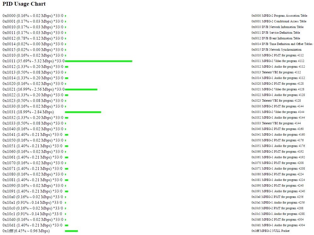

PIDs canal 56
Canal 22
PAT Version Number: 29
Transport Stream ID: 1 (0x0001)
NIT: 482.0 MHz
PMT PID 16 (0x0010) - Network
PMT PID 4112 (0x1010) - Program 4112 EEN EIT Link
PMT PID 4128 (0x1020) - Program 4128 Canvas EIT Link
PMT PID 4144 (0x1030) - Program 4144 Ketnet EIT Link
PMT PID 4160 (0x1040) - Program 4160 Radio 1 EIT Link
PMT PID 4176 (0x1050) - Program 4176 Radio 2 EIT Link
PMT PID 4192 (0x1060) - Program 4192 Klara
PMT PID 4208 (0x1070) - Program 4208 Studio Brussel EIT Link
PMT PID 4224 (0x1080) - Program 4224 MNM EIT Link
PMT PID 4240 (0x1090) - Program 4240 Klara Continuo
PMT PID 4256 (0x10a0) - Program 4256 Sporza
PMT PID 4288 (0x10c0) - Program 4288 VRT NWS
PMT PID 4304 (0x10d0) - Program 4304 MNM Hits
Network PMT Entry - carried on PID 16 (0x0010)
Program Number: 4112 EEN
Stream Type: 0x02 MPEG-2 Video PID 4113 (0x1011)
AFD descriptor: Active format is the same as the coded frame
Descriptor: STD Descriptor
Leak Valid Flag: 1
Descriptor: User Private Descriptor: 0x86
e0 .
Descriptor: Video Stream Descriptor
Multiple frame rate flag: True
Frame rate: 25
MPEG-1 only flag: False
Constrained paramter flag: True
Still picture flag: False
Stream Type: 0x03 MPEG-1 Audio PID 4114 (0x1012)
MPEG1 Audio: Layer II Mode Joint Stereo
Descriptor: Audio Stream Descriptor
Free format flag: False
Layer: 2
Variable rate audio indicator: False
Language: dut
Stream Type: 0x06 Teletext/VBI PID 4115 (0x1013)
Language: dut Type: Initial Teletext page Magazine: 0x01 Page: 0x00
Stream Type: 0x03 MPEG-1 Audio PID 4116 (0x1014)
Language: tha
Audio type: visual impaired commentary
Program Number: 4128 Canvas
Stream Type: 0x02 MPEG-2 Video PID 4129 (0x1021)
Leak Valid Flag: 1
e0 .
Frame rate: 25
Stream Type: 0x03 MPEG-1 Audio PID 4130 (0x1022)
Layer: 2
Stream Type: 0x06 Teletext/VBI PID 4131 (0x1023)
Program Number: 4144 Ketnet
Stream Type: 0x02 MPEG-2 Video PID 4145 (0x1031)
Leak Valid Flag: 1
e0 .
Frame rate: 25
Stream Type: 0x03 MPEG-1 Audio PID 4146 (0x1032)
Layer: 2
Stream Type: 0x06 Teletext/VBI PID 4147 (0x1033)
Program Number: 4160 Radio 1
Stream Type: 0x03 MPEG-1 Audio PID 4161 (0x1041)
Layer: 2
Program Number: 4176 Radio 2
Stream Type: 0x03 MPEG-1 Audio PID 4177 (0x1051)
Layer: 2
Program Number: 4192 Klara
Stream Type: 0x03 MPEG-1 Audio PID 4193 (0x1061)
Layer: 2
Program Number: 4208 Studio Brussel
Stream Type: 0x03 MPEG-1 Audio PID 4209 (0x1071)
Layer: 2
Program Number: 4224 MNM
Stream Type: 0x03 MPEG-1 Audio PID 4225 (0x1081)
Layer: 2
Program Number: 4240 Klara Continuo
Stream Type: 0x03 MPEG-1 Audio PID 4241 (0x1091)
Layer: 2
Program Number: 4256 Sporza
Stream Type: 0x03 MPEG-1 Audio PID 4257 (0x10a1)
Layer: 2
Program Number: 4288 VRT NWS
Stream Type: 0x03 MPEG-1 Audio PID 4289 (0x10c1)
Layer: 2
Program Number: 4304 MNM Hits
Stream Type: 0x03 MPEG-1 Audio PID 4305 (0x10d1)
Layer: 2
Network Name: VRTmux1
Network ID: 13313 (0x3401)
Original Network ID: 8248 (0x2038) Version: 11
DVB-T Frequency 482.000 MHz
Bandwidth: 8 MHz Constellation: 64-QAM
Hierarchy: non-hierarchical, native interleaver Guard Interval 1/4
Code Rate: 1/2
Service: 4112 (EEN) digital television service
Service: 4128 (Canvas) digital television service
Service: 4144 (Ketnet) digital television service
Service: 4160 (Radio 1) digital radio sound service
Service: 4176 (Radio 2) digital radio sound service
Service: 4192 (Klara) digital radio sound service
Service: 4208 (Studio Brussel) digital radio sound service
Service: 4224 (MNM) digital radio sound service
Service: 4240 (Klara Continuo) digital radio sound service
Service: 4256 (Sporza) digital radio sound service
Service: 4288 (VRT NWS) digital radio sound service
Service: 4304 (MNM Hits) digital radio sound service
SDT Channel 4112
Service Name: EEN
Provider Name: VRT
Transport Stream ID: 1 (0x0001) 482.0 MHz
SDT Channel 4128
Service Name: Canvas
Provider Name: VRT
SDT Channel 4144
Service Name: Ketnet
Provider Name: VRT
SDT Channel 4160
Service Name: Radio 1
Provider Name: VRT
SDT Channel 4176
Service Name: Radio 2
Provider Name: VRT
SDT Channel 4192
Service Name: Klara
Provider Name: VRT
SDT Channel 4208
Service Name: Studio Brussel
Provider Name: VRT
SDT Channel 4224
Service Name: MNM
Provider Name: VRT
SDT Channel 4240
Service Name: Klara Continuo
Provider Name: VRT
SDT Channel 4256
Service Name: Sporza
Provider Name: VRT
SDT Channel 4288
Service Name: VRT NWS
Provider Name: VRT
SDT Channel 4304
Service Name: MNM Hits
Provider Name: VRT

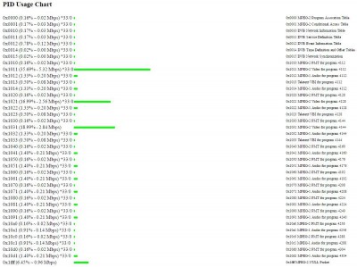

Capture_22_.JPG -->
PIDs canal 22
