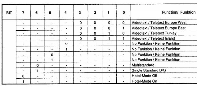

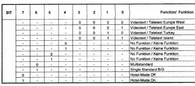

Messagepar Mannix54 » 01 Mai 2017 21:28
sur les modèles de TV thomson/brandt vendus au grand public il y avait aussi un mode hôtel activable dans un menu caché,
exemple pour un thomson ou brandt qui a un chassis ICC6 :
Entering the Service-Mode:
- Switch off the mains-switch
- Press “Volume +” and “Volume -" button simultaniously
- Switch on the set with the mains-switch
- Keep both buttons pressed until following message
appears on the screen:
Prozessortyp B73 00000000
In the Service-Mode:
Eight digits show the status of each data bit.
To select a bit use the keys O-7 of the remote control.
The keys have a toggle function. If you press a key once the
status becomes ‘1”. Another press of the same key changes
the status to “0”.
For example: To change bit 0 you have to press the key “0” on
the remote control.
il y a un code à 8 bits à entrer avec la télécommande :
- To exit the service-mode press the "TV" or the
‘Stand-By” key.
- If the service mode is exited properly the datas are
automatically stored.
- In the Hotel-Mode it is not possible to enter the
PROGRAM-menue and the OMA-menue. VOLUME is
limited, but the display shows the full range
Mannix54
