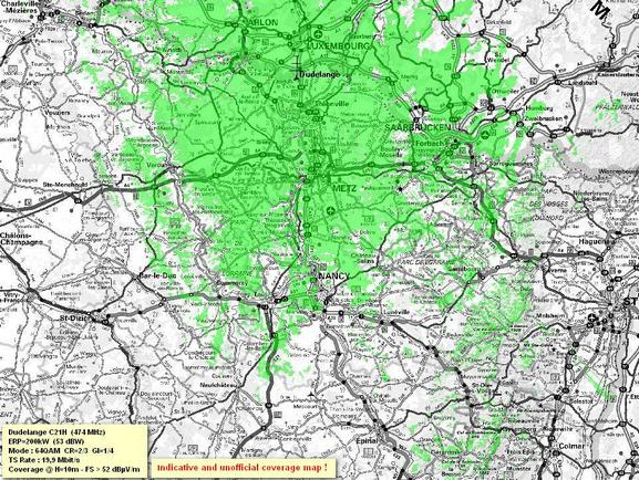

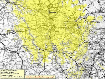

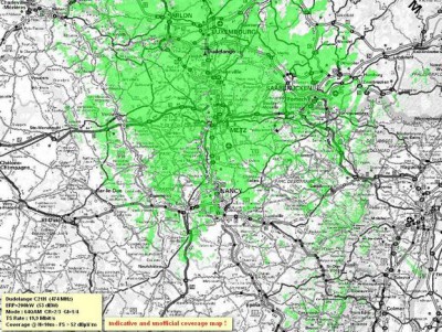

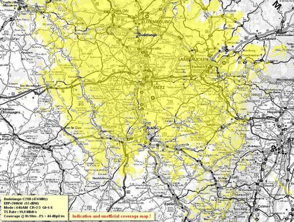

Here are indicative and unofficial C21 coverage maps (not coming from BCE). Reception antenna height is 10 m above the ground (rooftop mounted). Coverage is highlighted in two flavors:
- Green pattern : standard antenna installation. Field strength level requirement : 53 dBµV/m or higher.
- Yellow pattern : advanced antenna installation (higher antenna gain and optionnal use of a low noise mast amplifier). Field strength level requirement : 45 dBµV/m or higher.
Extra coverage is also possible (not depicted here), but without any guarantee on long term availability due to lack of propagation margin and/or possible interferences. In any case don't forget that these maps are computed and only DTM based.
DudelangeC21-IndicativeCoverageMap-45dBµVm.jpg -->
DudelangeC21-IndicativeCoverageMap-53dBµVm.jpg -->
Master Blaster
Messages: 1
Inscription: 01 Mar 2011 20:50
Re: [Luxembourg] Emetteur de Dudelange - Ginsterberg
Messagepar sam_ » 02 Mar 2011 00:19
Master Blaster a écrit:Here are indicative and unofficial C21 coverage maps (not coming from BCE). Reception antenna height is 10 m above the ground (rooftop mounted). Coverage is highlighted in two flavors:
Many thanks for your measurements. Is there any way to get high resolution map that could give us more indications ?
En tous cas, bonne couverture du canal 21. Dommage que le Père Noel se soit perdu en escaladant le Ginsterberg? Let's wait and see.
