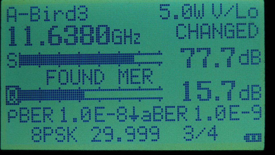

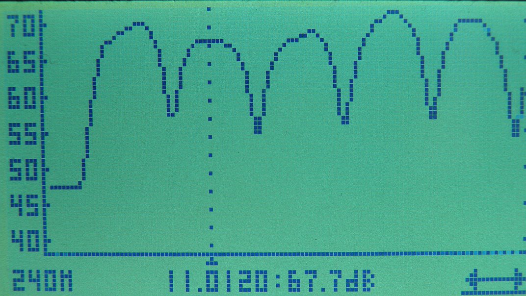

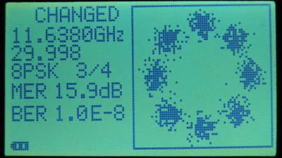

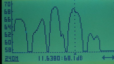

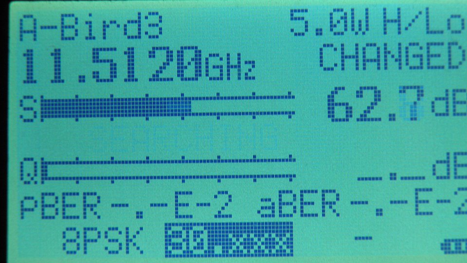

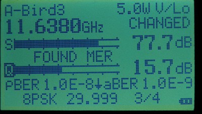

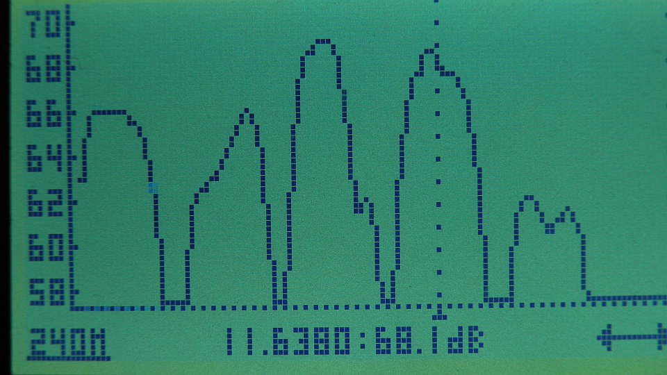

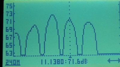

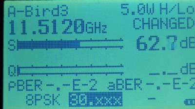

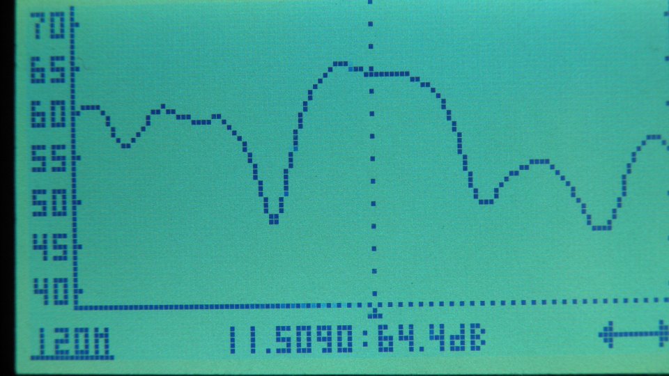

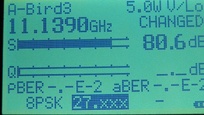

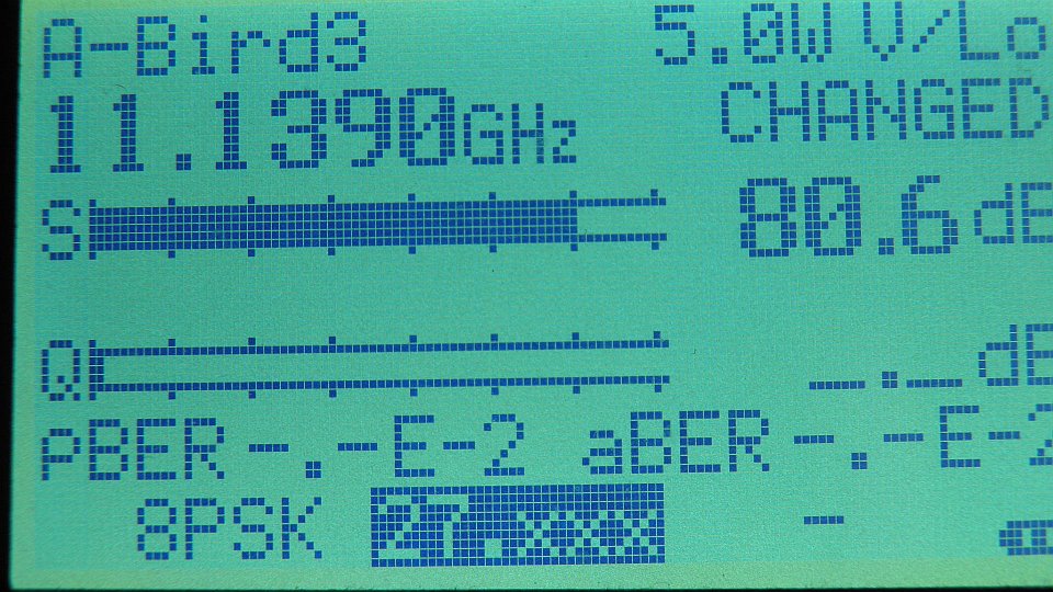

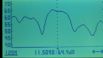

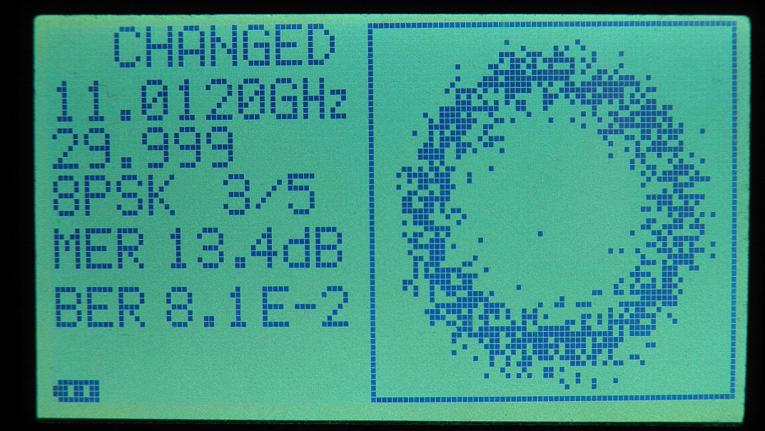

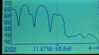

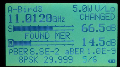

Messagepar EnoSat » 25 Nov 2010 19:03

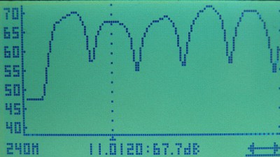

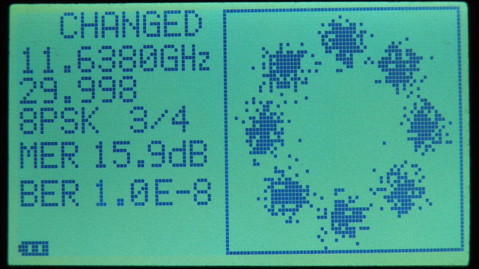

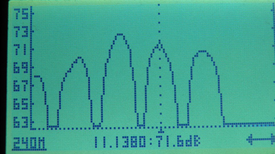

Some pict from 5 West
11139 V and 11509 H no lock , but transponders active
11012 V and 11638 V use DVB-S2/8PSK Multistream and DVB-S2/8PSK
11638c.jpg -->
11638m.jpg -->
11638s.jpg -->
11512m.jpg -->
11512s.jpg -->
11139m.jpg -->
11139s.jpg -->
11012c.jpg -->
11012m.jpg -->
11012s.jpg -->

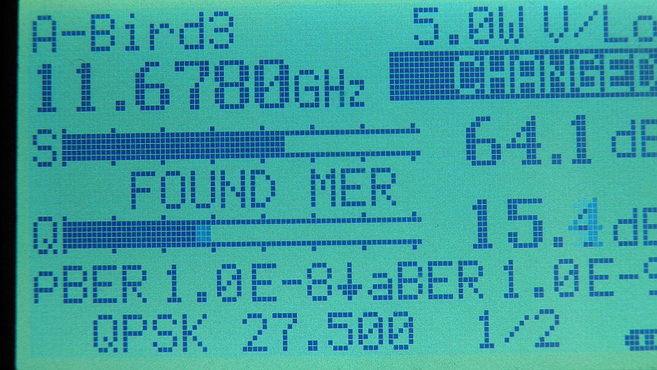

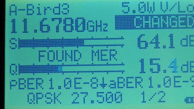

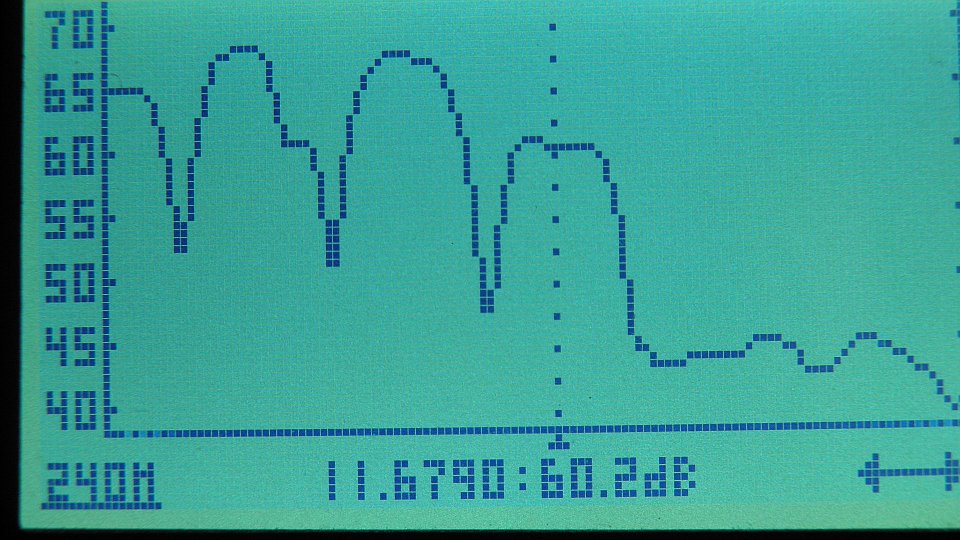

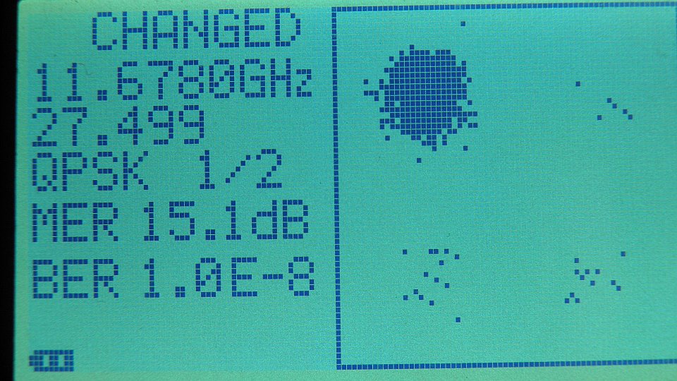

Messagepar EnoSat » 25 Nov 2010 19:04
Part2

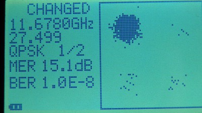

11678 V use some unknown modulation
11678c.jpg -->
11678m.jpg -->
11678s.jpg -->

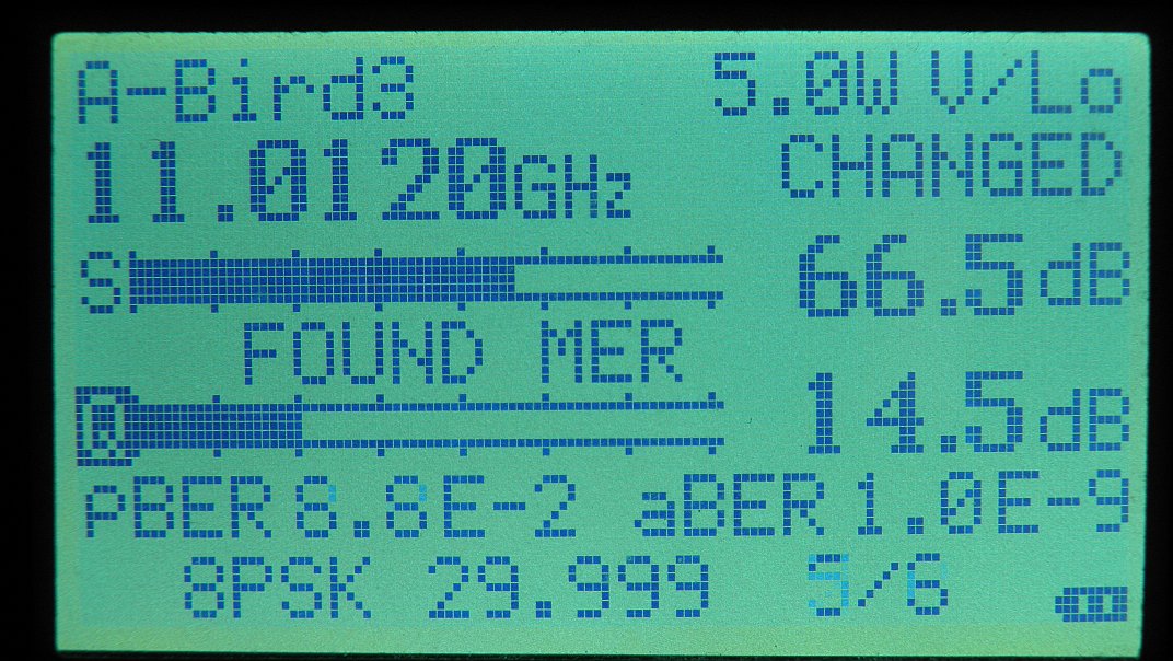

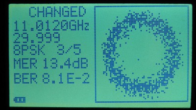

Messagepar EnoSat » 22 Sep 2012 06:54
actual status:
11012 V - SR 30000 , DVB-S2/8PSK FEC-3/5 ACM/VCM , MER 13~14dB , PLS-Root-16416 , Multi-2 & 3 & 11
11137 V - unknown - some APSK
11178 V - SR 30000 , DVB-S2/8PSK FEC-3/5 ACM/VCM , MER 13~14dB , PLS-Root-16416 , Multi-4 & 5 & 12
11512 H - unknown
11637 V - SR 30000 , DVB-S2/8PSK FEC-3/5 ACM/VCM , MER 13~14dB , PLS-Root-16416 , Multi-1 ~ 6
11675 H - SR 30000 , DVB-S2/8PSK FEC-2/3 ACM/VCM , MER 13~13dB , PLS-Root-16416 , Multi-7 ~ 16
12585 H - SR 27500 , DVB-S2/8PSK FEC-2/3 CCM , MER 13~14dB , PLS-8 , Multi-1
12607 V - SR 29900 , DVB-S2/8PSK FEC-2/3 CCM , MER 13~14dB , PLS-8 , Multi-1 & 2
12669 H - SR 29900 , DVB-S2/8PSK FEC-2/3 ACM/VCM , MER 15~16dB , PLS-8 , Multi-1
all for DVB-T & DVB-H transmitter`s
PS: some info about 11137V and 11512H ?

Re: TNT contribution
Messagepar marceljack » 28 Sep 2012 10:01
Copy of my answer on another thread:
Hi EnoSat,
These two transponders (11137V and in fact 11509H) use a special 8-PSK modulation system from Newtec which is neither DVB-S nor DVB-S2.
Each of these transponders transmits "as is" (i.e. unencrypted for FTA channels, encrypted for pay channels) two multiplexes of the French TNT (R2 and R3 on 11509H, R4 and R6 on 11137V) in order to supply the signal to terrestrial transmitters.
The R1 multiplex is transmitted in standard DVB-S on 11591V.
For more detail:
http://fr.kingofsat.net/pos-5W.php
Messages: 23854
Messagepar EnoSat » 28 Sep 2012 13:24
thanks,
known model type newtec demodulator use on DVB-T transmiters for this signal ?
