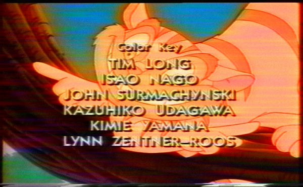

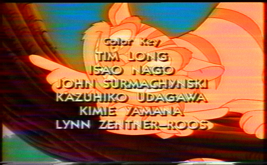

finalement le gars a réussi à décoder la chroma de la cassette VHS, mais ce n'est pas encore parfait :
just want to note that there is some rudimentary color support now! Doesn't work as well on all my captures yet, but it's a start, need to work on automatic frequency/phase control next (like in a VCR) to compensate better for the effect tape jitter has on color
